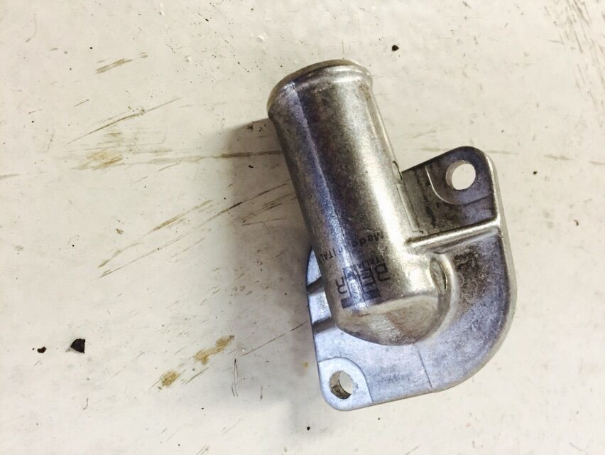

I got my machined two part thermostat back and fitted it on Tuesday. Had to use a sud 30mm longer pipe, as the 33 one is too short.
I got a BGA CT5496 thermostat, as recommended by alfa for a sud or early 33.
Pics of original top
Car gets to temp in 9 mins, inc 2 mins at idle.
I can see the temp drop at just over 80c to just under 80c.. ok normal up to this point. Before the temp used to then stay at just under 80c.
Now the temp sits just over 80c and fluctuates up to just under 90c, it never did this before.
The fan comes on at just under 90c when idling.
This is the first time I have had the 2 part thermostat, can anyone else with one, i.e you sud guys, advise please.
I'm thinking the stat isn't opening enough and the cooling is coming from the fan switching on whilst driving, surely not desired.
Thanks Alan
